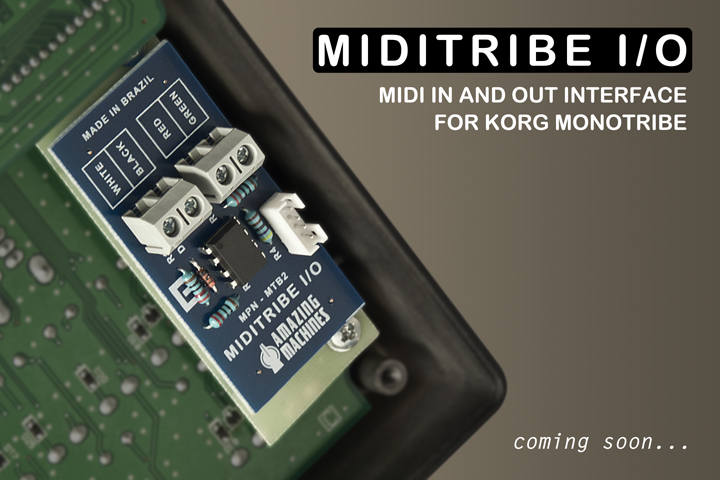

PostPosted: Wed Feb 15, 2012 1:07 am    Post subject: Reply with quote Add User to Ignore List
Amazing Machines
Joined: 29 Sep 2011
Last Visit: 30 Apr 2013
Posts: 44
Location: Brazil
PostPosted: Wed Feb 15, 2012 1:10 am    Post subject: Reply with quote Add User to Ignore List
For more information on the MIDITRIBE I/O please have a look to this Synthtopia post:
http://www.synthtopia.com/content/2012/02/12/amazing-machines-miditrib e-io-for-korg-monotribe-teaser/
