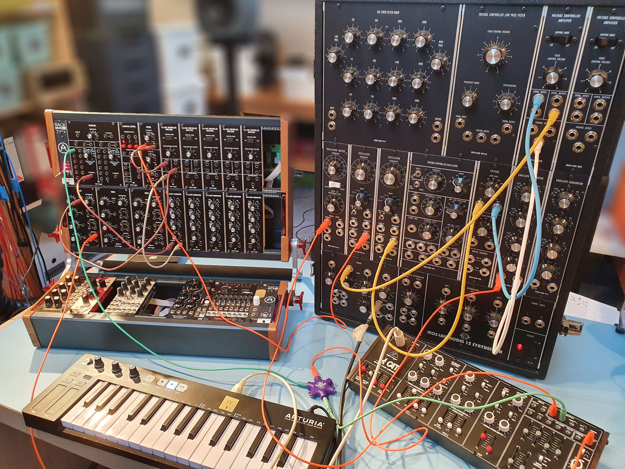

I built a preliminary System 55 with the first 6 available modules.
I found some problems with the 923 filters (manual LP/HP). Just before fully opening the LP, there's a sudden jump in cut-off frequency to full open. Also, there seems to be some weird wobbling/fluctuating of the sound before this jump. I noticed it first with the LP, but the HP seems to have the same problem. It also has the weird jump (and fluctuating), but at about the same knob positon as the LP, so just before almost closing (at the 10khz cutoff freq). In comparison, the Mos-Lab 923 doesn't exhibit this and smoothly opens (LP) and closes (HP). I will investigate furter, but probably will return it and try another one.
1 out of 5 envelope generators (911) doesn't work. There seems to be a bit of variation in their ADSR-settings (calibration?), but overall the 4 ones that work do perform well. But.. while inspecting and comparing these 911's, I noticed something weird on the PCB of one of the working 911's. A group of components was covered in a big dot of leftover flux.. there was some metal dirt sticking to it.. I could remove it with a tweezer. Seems pretty sloppy. Also the SMD-soldering was.. uhm, well let's say I do a better job soldering SMD by hand.
On the plus side: all VCA's (902) and mixers (CP3A-M) do work and sound really nice!

Thank you for the report. Didn't realize these were already out in the wild. Also glad to see you have mos-lab for direct comparison.
Glad the VCAs get a plus report. Too bad they've done CP3A mixer. That's a typical opamp mixer. CP3 is discrete.
