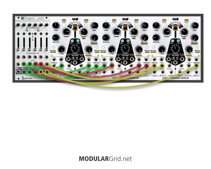

Sync raises some great meta-level points, especially with regard to sequencing and sentence coherence.
With regard to sampler, the 4MS Stereo Triggered Sampler would be ideal. Most importantly, it has an end-of-sample gate output. It also has a record function. The downside is that it only has CV control over 20 samples at a time (2 banks of 10 samples). You can store up to 60 banks with 10 samples each in the sampler, but CV can only select from two banks at a time.
Because of the STS' end-of-sample functionality, I think you could get away with just lining them up with a Mutable Stages.
I think you can use Stages as either a sequential Sample & Hold (in a chain of end-of-sample gates) or manually triggering and CVing each segment of the "sentence". Here's a quick patch sketch...
