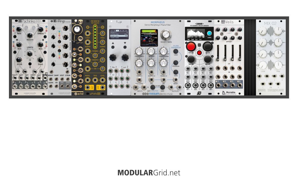

In the meantime, I'm wondering if Pam's is a necessity since I have Marbles for sequencing/clock purposes and having 8 lfos already I might not need too many more. Apparently the envelopes of Pam's are quite snappy, they aren't long. This setup also only gives me 2 vca.
Veils has been recommended to me for vca purposes. I did another sketch without Pam's and with Veils. I added Zadar as it seems really flexible, doing vco, envelopes, lfo... Maybe I'm missing something here and Pam's sketch would be better but I honestly quite like this one:

Looks like a fun rig. There's an alt firmware for Marbles (will run on Pachinko) that gives you up to 128 steps instead of the max 16 on the standard firmware. You can grab it here - there's also a chart a few posts above that shows you the spread knob layout to get each division. 128 might be a bit too many, but I find 32 and 64 very useful.Jturbide wrote: ↑Wed Feb 24, 2021 3:00 pmThanks alot Voltcontrol, I can't wait to receive everything I ordered and start figuring things out.
https://forum.mutable-instruments.net/t ... y/16248/11
One thing to note is that the Ts-L expects bipolar +-5v on it's VC (mod) inputs, and the Zadar outputs unipolar 0 up to 10v (scalable). Pam's is the same. If you end up with a partner case to this one, grab a Frap Tools 321. It can invert and offset, so you can turn a 5v unipolar output into a +-5v bipolar signal. The Ochd outputs bipolar, so that's fine. You'll still be able to use the Zadar for mod inputs on the Ts-L, you'll just need to be creative with the attenuator positions to get what you want. Don't let that put you off the Ts-l though, it's a great choice.
Also worth noting that the Zadar doesn't have a clock input, so if you're going to want to do any clock based modulation, Pam's might be a better option, but you can dial the envelope/loop time on the zadar down to the millisecond, so you can normally get it in time manually if needed. Pam's does have more options, such as wave shape, including random, and quantized random, skip, slop, euclidean rhythms, phase offset, wave width, and more. While it's time based, you don't have to clock it to the Marbles, so you could let it run on it's own time at a different tempo, and the multiply/division options are wide enough that you can have each channel unsynced from each other. Watch DivKid's video on Pam's if you haven't already.
You could swap out the Veils for a Doepfer 142-2, which gives you VCAs and envelopes in one. Though not sure if 2 VCAs would give you enough if you want to use multiple wave shapes outs from the Ts-L at the same time with different envelopes?

For the Ts-l it does seems great but also expensive and probably a bit rare on the used market. I might go with a cheaper option but I'll keep it on my radar.
Ok so Pam's is clockable and can do more than the zadar, but for pure envelopes zadar might be better ? Man its so hard to choose. I might even get something else than can do clockablre envelopes ? Or similarly to my previous sketch, get Pam's, but maybe try to find a smaller vco and try to squeeze a dedicated envelope. Or maybe even swap veils for the doepfer 142-2 and squeeze in another small single or dual vca.

Yeah a microplaits could be really nice. It also has it own lpg so it does not need a separate filter and vca. I'm gonna seriously consider this one, maybe with a erica pico vco or another really small vco. That way I should not need too many vca and filters. I would then have Rings, Plaits and another vco as principal sound sources. I could then focus en something like the doepfer 142-2 (vca+envelope) or a quad vca/mixer and a dual envelope module , a filter, etc...
I'm having more problems trying to figure out the mixer, vca, envelope, clock. I for examplecdon't know if I want a PNW yet. I'm also trying to find a good mixer/panning module but I might actually don't really need much if I already have an outboard mixer ?
Back to modulargrid
Back to modulargrid

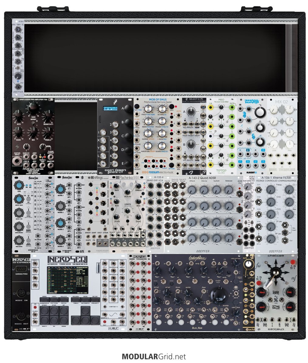

Update:
48hp left, here are all the modules I am waiting to receive.
The Zzzorb has a linear vca so maybe a doepfer 142-2 or some other dual lin/exp vca would be enough ?
Still eyeing Plaits, Zadar, Temps_utile, O_C...
