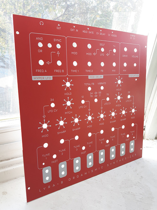

Made some panels at work today, turned out nice. UV print with white ink. I still have to hit it with a clear coat, but it's already pretty scratch resistant! Anyone have any suggestions on what I should coat it with?
Many thanks to secrethero303 for the FrontPanel files! I inserted part of my design in and it worked out perfectly.
Also, considering I can print directly to the aluminum sheet, different color combos/designs are a breeze.
I'm getting a quote on a dozen pre drilled sheets, and over this weekend I will be coating the panels I have and testing scratch resistance, which should be solid.
