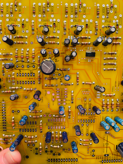

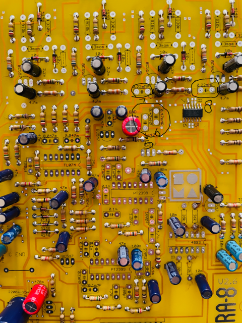

I finished off this project (photos here) so thought I'd share some notes.
Overall it was a lot of fun! The build guide was really helpful. Props to @flounderguts for such nice documentation. The boards are very high quality too.
Tips for builders:
One thing I'd suggest to everyone would be to add resistance to the attack side to bring it into the suggested range of 300k to 1M. I lit up some pots during testing as the attack resistance dropped to 0. Otherwise I used the suggested values in the build doc which worked as described.
The other suggestion I have is to get the stock Lyra working first, learn what it is supposed to sound like, then modify it. There's no schematic, and it is very challenging to troubleshoot.
A dupont crimper kit came in very handy in building jumpers and making removable connections between everything. Fly the jumper wires at a decent height above the panel to allow access to resistors and switches.
I mounted the power inlet and switch on perfboard which gave it some stability, but a chassis-mount would be better.
Overall it's been a very fun project and everything is useful as-is. I'm looking forward to further baffling my family and friends with my idea of "music." :-)
Some suggestions for future PCB revisions:
All this may be assembly error on my part, but many of the functions on board B seem like they're backward. The values for the distortion switch provide a good range, but turning the switch clockwise produces a less pronounced effect. Turning the range switches clockwise shift voices to a lower range. Vibrato frequency decreases as pots are turned clockwise, and left/"off" engages the expansion vibrato which was the opposite of what I expected, even though I followed the convention in aligning the switch notch to the empty dot on the panel.
Board B switches would be more intuitive to use if they were oriented vertically instead of horizontally, to match how they work on board A.
The PCB has components that extend across the whole rack width, with footprints and components within a few mm of my metal rack, so I worry a bit about shorts, and I imagine it's going to be tough to find a chassis to fit. The specified film caps on the distortion section are the most exposed, and they have very thin leads, so they tend to get bashed around a lot during assembly.
I stiffened the expansion board with aluminum angle fastened with 2 part epoxy which worked great. I think the main panel needs a bit of room on the bottom to accept a similar treatment since the panel tends to flex during use. Maybe a chassis will solve this problem.
Thanks again @flounderguts!

Post by Flounderguts » Thu Jan 07, 2021 9:56 pm
Stoneyards wrote:
Wed Jan 06, 2021 11:46 am
Tips for builders:
Yeah, on my initial build I smoked an attack pot, too. But I haven't had any issues since...hmmm. I'll revisit that!
PM'd you about that.
You're right, we need a better internal power solution.
No, not error on your part. I noticed that on the first set of wings when I built it. The V.2 wings have the switch directions changed. It's easy to get turned around when you're placing footprints on the backplane! But on the V.1 wings, you could snake the contacts from the switches around using some of the many snipped legs.
:sstorm:
Yep. I might have tried to be too fancy.
Yeah, that's legit. I had to grind away my rack a bit to get it all to fit!! I did manage to find a few more mm of clearance on the V2 wings and integrated panel. Also, I am in the process of swapping some ceramic caps in for distortion to see how they sound. If it's good, then the smaller blobs of ceramic might help there as well.
You might be right. I did end up making a set of integrated expansion panels after seeing how flexy the IO panels were! I'm hoping to get a second PCB attached down there for the gate in mods (which I'm trying to make backwards-compatible with the IO panel) which will help stiffen stuff up on both styles. You bring up a good point about the chassis. Maybe I can figure out something that would brace the main board mounts against the rack uprights, but I worry about the strength of the little blobs of epoxy at the bottom of the posts.
But I see no way of getting all of this into a chassis (which is only 17" inside) without major changes.
Thanks for the kind comments! The whole thing *is* a bit of a kludge, but I wanted to sort of honor the experimental nature of the original instrument. I am eager to get more feedback from you when you've had more time with it!
one of the ideas I've been kicking around is that there is a bit of a gap between the long release of the "FAST" mod, and the short release of the "SLOW" mod. My thinking is that I could eliminate the "FAST" release section altogether, and instead spec a pot with a very short release value on one end...then when you switch it from FAST (on the central panel) to NOT FAST, you get a mod circuit that covers the entire range of release values from very snappy to as long as you want to make it (I have both 15M and 20M pots)
That would free up almost an inch, and if I tightened things up on the B side, I could perhaps get all the mods on a single board, and perhaps inside the 17" chassis limitation.
Flounderguts

Post by Flounderguts » Mon Jan 11, 2021 11:23 pm
Not positive, but there are basically 4 quad opamps on board...3 TL074 and one TDA2822.
There are some summed voices there, and I think they go to the pins marked FMxx, and then to mixdry1 and mixdry2. Then it goes through the filter circuit, and then to final out. The mixing balance seems to be at the TDA2822.
Mostly I think it will involve some probing with an audio output jack. I probably won't have time for this until February (I'm still away from my studio for another 10 days), but I don't think it will be too hard to find where to tap the signals. The issues are more to do with the pan. Also the filter section is decidedly mono. I'm not exactly sure what strategy to use, there!
Maybe we should invite @guest to take a look at the Lyra...he's probably the best circuit analyzer guy around here that I can think of!

Post by mutronic » Mon Jan 18, 2021 8:13 pm
Just making sure, should I be omitting the resistors in the tweaks section for the expansion boards?
Flounderguts
Posts: 1052
Joined: Thu Dec 07, 2017 5:56 pm
Location: SLC
Re: Lyra-8 DIY expansion and panels
Post by Flounderguts » Tue Jan 19, 2021 5:28 pm
Yes. Where a resistor or cap would be "tweaked," those leads go to a switch or potentiometer on the wings. There are switches on the wings that use the original values, so you can still play a "stock" Lyra-8 DIY.
On the voice switches, there are electrolytic caps, so make sure you have the grounded side to the place marked "-."
Good luck!!

Post by mutronic » Wed Jan 20, 2021 4:10 pm
One of this things I've noticed thus far is the new PCB design is somewhat revised than what the tweaks file displays. I think the capacitance for voices 5-8 are pretty much the same, but 1-4 are different. Here are some pictures, and tell me if I'm wrong for assuming the capacitance for the voices on these.
Flounderguts
Posts: 1052
Location: SLC
Post by Flounderguts » Wed Jan 20, 2021 11:00 pm
You're not wrong, if you are working from Vlad's original "tweaks" document.
The mods I made were based off a board the same as you are building. I'm pretty sure I covered that in the build guide, but if you don't see it, send me an edit!
Flounderguts
