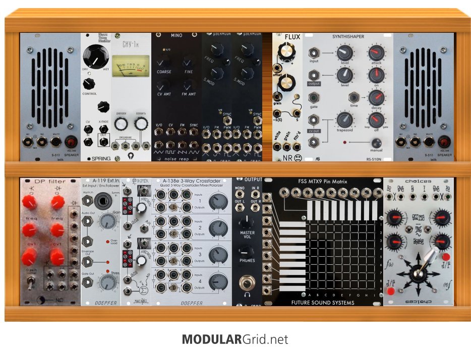

I would like to build out a rack to fit a Halliburton case with two rows of 84 HP. I am fascinated by EMS. While I do not want to replicate exactly an EMS Synthi I would like to emulate the exotic textures/ sounds and controls. Pictured is a mockup of my idea of a Synthi like rack using mostly Doepfer. What am I missing, what would you expand on if your Synthi could do this or that?

What you're missing is a Synthi is much more than the sum of its parts and attempting to "emulate the exotic textures/ sounds and controls" or even only get anything close to its sound, behaviour and interface with any assembly of eurorack modules is a pointless waste of time, money and energy. Many tried, no one succeeded.

Feel like a big part of the Synthi "feel" is the patch matrix, which AFAIK there is no Euro equivalent to. Not that what you have there looks to be a bad system by any means. I would probably add another A183-1 though, as a big part of the patch matrix is being able to attenuate signals via differently resistive pins.

I totally agree with Papz that trying to recreate the exact sound and experience of a EMS synth is a lost cause. With out the reverse topology and pin matrix of a EMS, you are loosing a lot right there. Also recreating ANY semi-modular with modular is fighting the circuit interactions that happen in an enclosed system where the sound sources were matched to the sound modifiers in ways that separate modules just don't replicate well. The ergonomic differences are obvious too.
To get a Synthi "work-alike", a system that has a closer functionality, I would change a lot of what you have shown above. I would get a bunch of modules from Analogue Systems. You can tell that those guys were heavily inspired by EMS stuff. They may not be exact clones, but many of their feature sets are very similar, and some are licensed copies (of course using newer components and being separate modules makes them NOT exact copies) of EMS gear. Get the RS-500E EMS Filter to replace the filters, the RS-501E Trapezoid Generator to replace the VCAs and EGs. Get the RS-95E to replace VCOs. You get the same wave shaping (added CV in), vernier frequency knobs, and frequency response adjustable close to the EMS (0.5v/oct instead of 0.32v/oct). The RS-85 VC LFO is also nice with similar wave shaping but added sync in.
The other modules can almost be any brand as far as I feel. Get a AC coupled Ring modulator, a decent Joystick (the planar is a good choice) and a good input module for external sources. Of course AS makes all of these, but here in the US, they are more expensive than Doepfer to other brands. They do make a good looking Pitch to voltage converter envelope generator external processor (RS-35) and a nice reverb (RS-310).
But you have to understand - THIS WILL NOT BE A SYNTHI. Without the patch matrix, the interactions of the modules to each other, the ergonomic form factor (one cannot underestimate the effect of this, the Synthi-A is un-arrayed in my mind), the general layout, you might as well go for a virtual instrument.

It will deliver better than any composite selection of modules. Has the pin matrix and the spring tank. Pricey perhaps, but certainly a bargain compared to the second hand EMS prices. A standalone instrument in the spirit of the Synthi.
Otherwise, perhaps some combo of the old analogue systems stuff to get at the flavor [trapezoid generator, oscillators]

You must know of analogue systems in the UK. They make all the modules to build as close to a synth as there is in modular. They have several modules licensed through EMS

Re: EMS like behavior in Euro
I think if might be worth a punt to ask this in the euro section, as there might be folks looking there who don't read this section.
Yes, the EMS is special as a system and cannot be replicated easily as a whole in Euro.
that said, why not experiment with a pin-matrix.
https://www.modulargrid.net/e/future-so ... pin-matrix
https://www.modulargrid.net/e/instruo-lion
Disclaimer, below is mildly inspired by, nothing more.
https://www.modulargrid.net/e/racks/view/1444824
