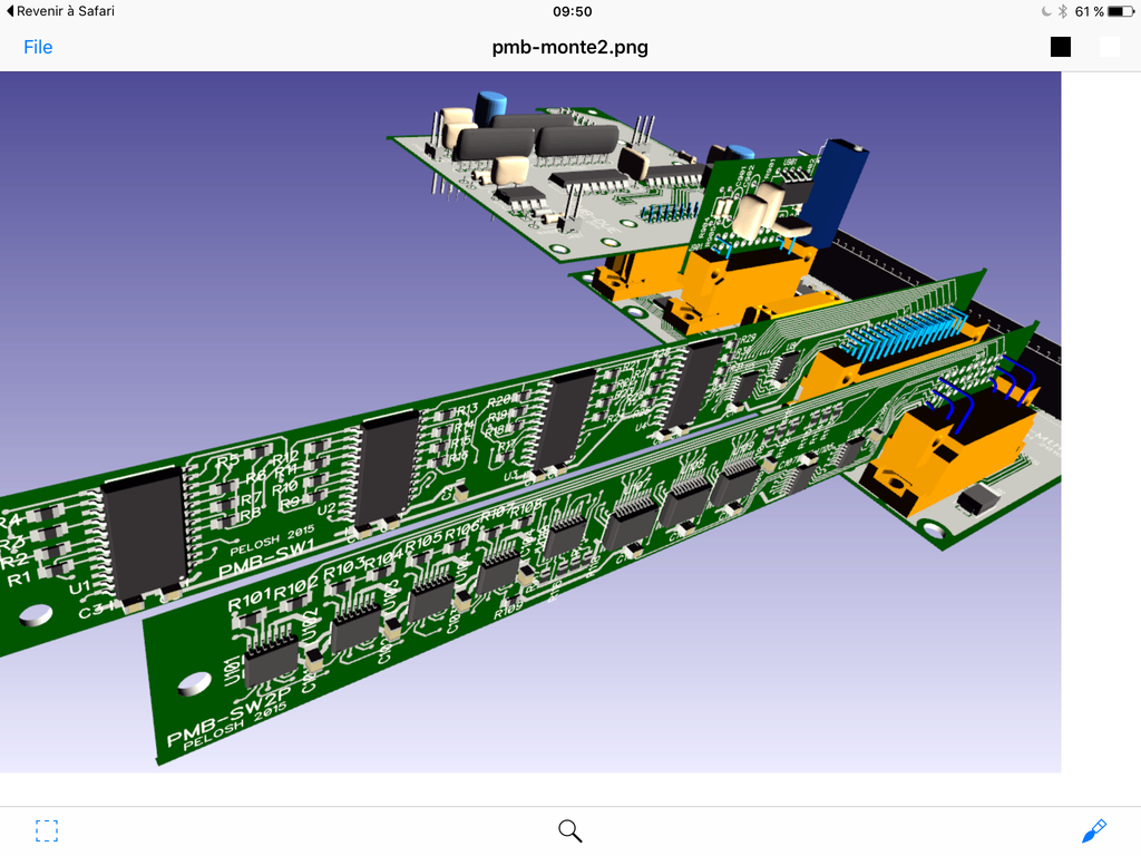

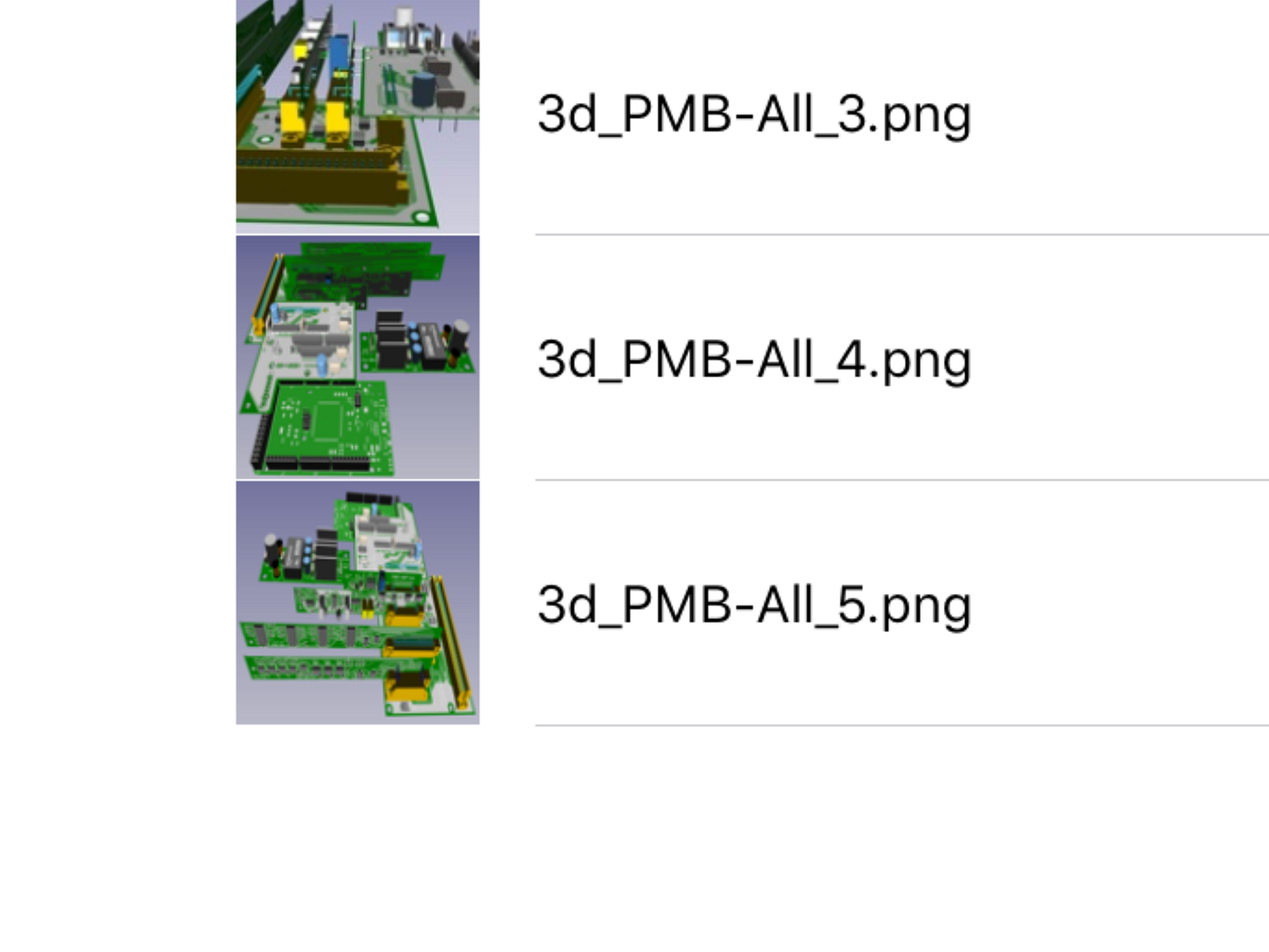

Post by boops » Thu May 05, 2016 1:28 am
All the pcbs are finished ,yeah! Now the code ;)
If you are REALLY interested,Please let your comment here ,i think perhaps,make a small preorder at a discount price .at least for 10 PMB (preset manager box)

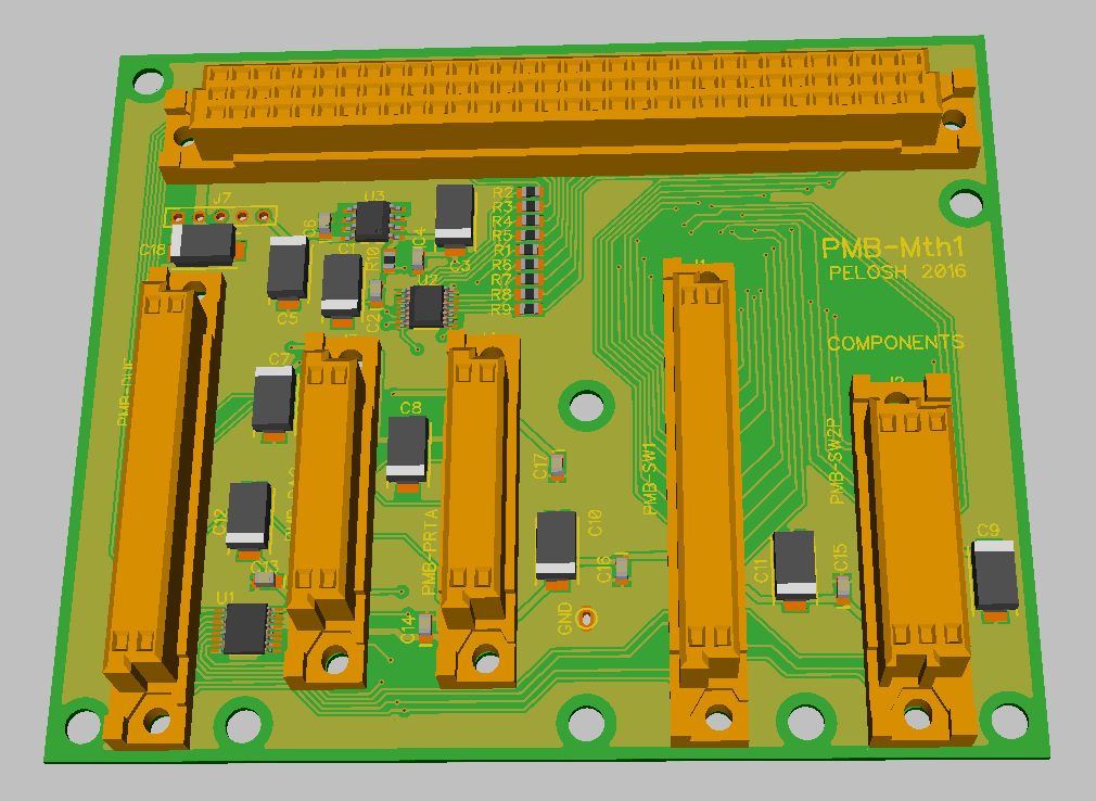

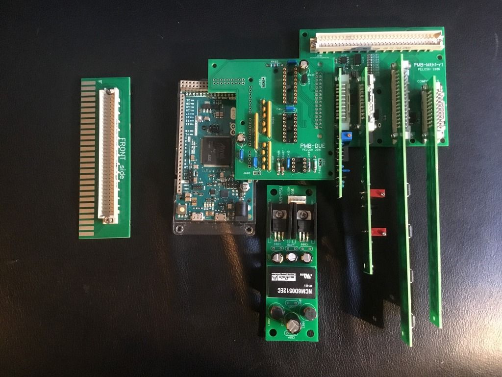

Post by boops » Mon May 23, 2016 3:12 am
Assembled without his box

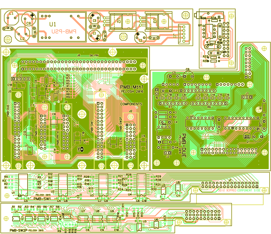

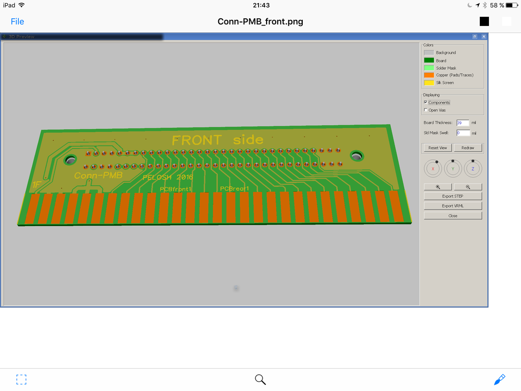

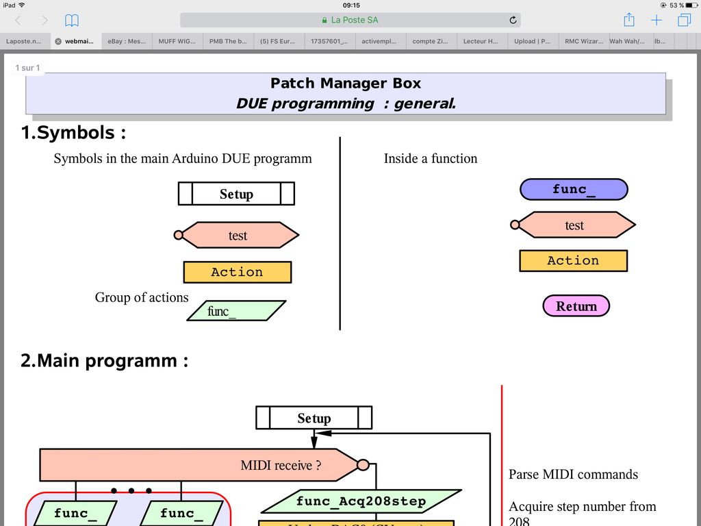

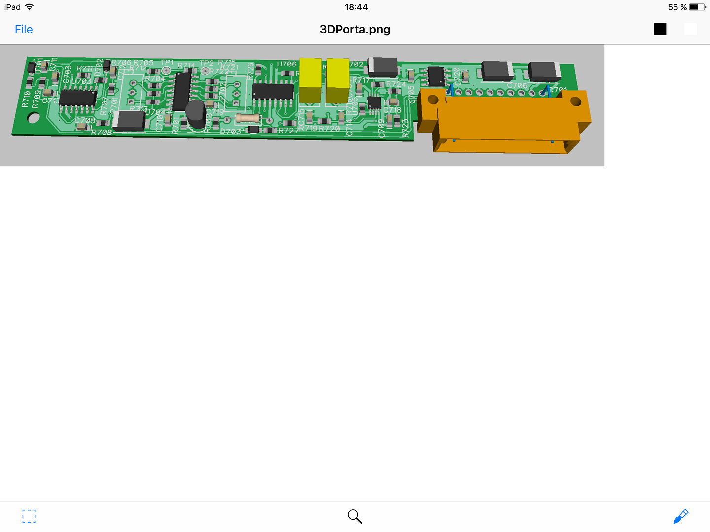

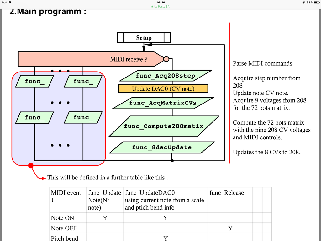

Post by boops » Mon Sep 19, 2016 12:08 pm
THe code grows up slowly;)
Porta PCB
Prototype pcbs are in production in France.

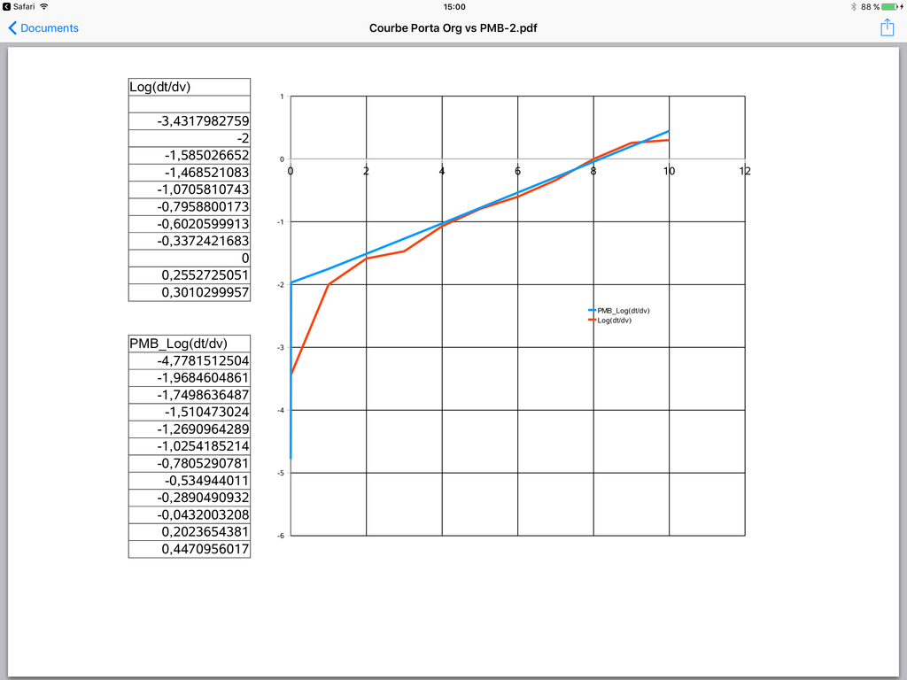

Post by boops » Tue Oct 25, 2016 8:27 am
Great log portamento of thé PMB

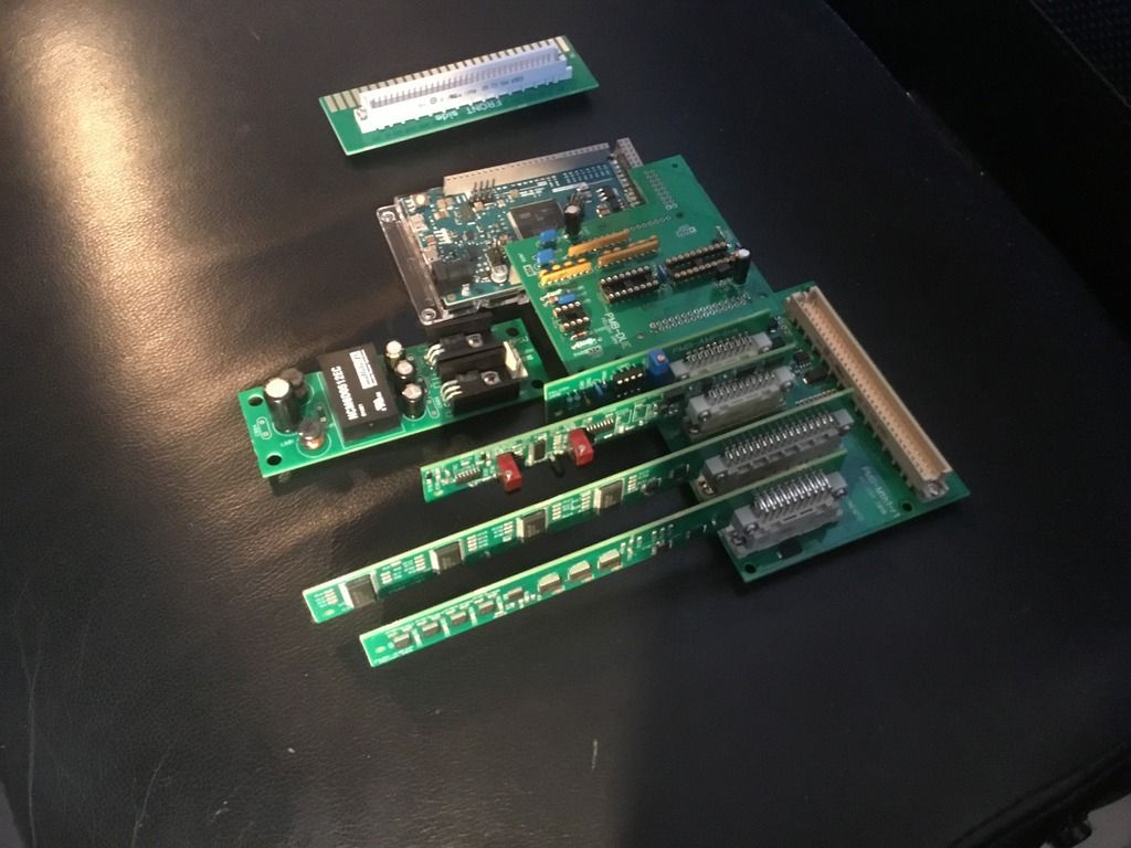

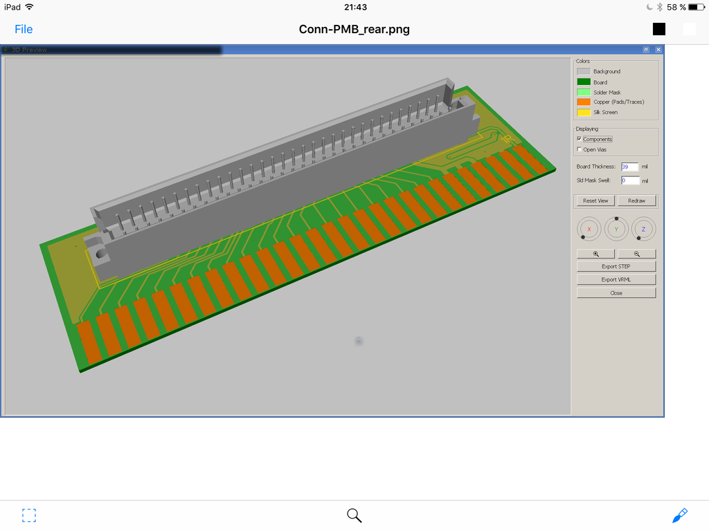

Post by boops » Sat Dec 03, 2016 1:41 pm
razzmtazz266 wrote:cant wait!!
After 2 years of work.
The real thing ...
-first two prototypes are almost assembled ,with great parts quality !
original real italian arduino
harting connectors ,so smooth
top psu for clean 12v logic circuit;
top notch aop opa77. etc
test of the code soon ;)

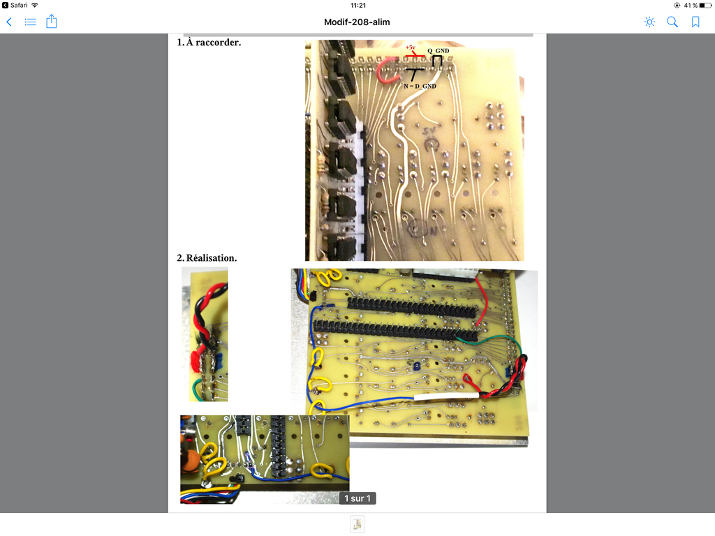

Post by boops » Fri Mar 17, 2017 4:54 pm
Below the 208!mod/ upgrade if you plan to use my future BPM preset manager box

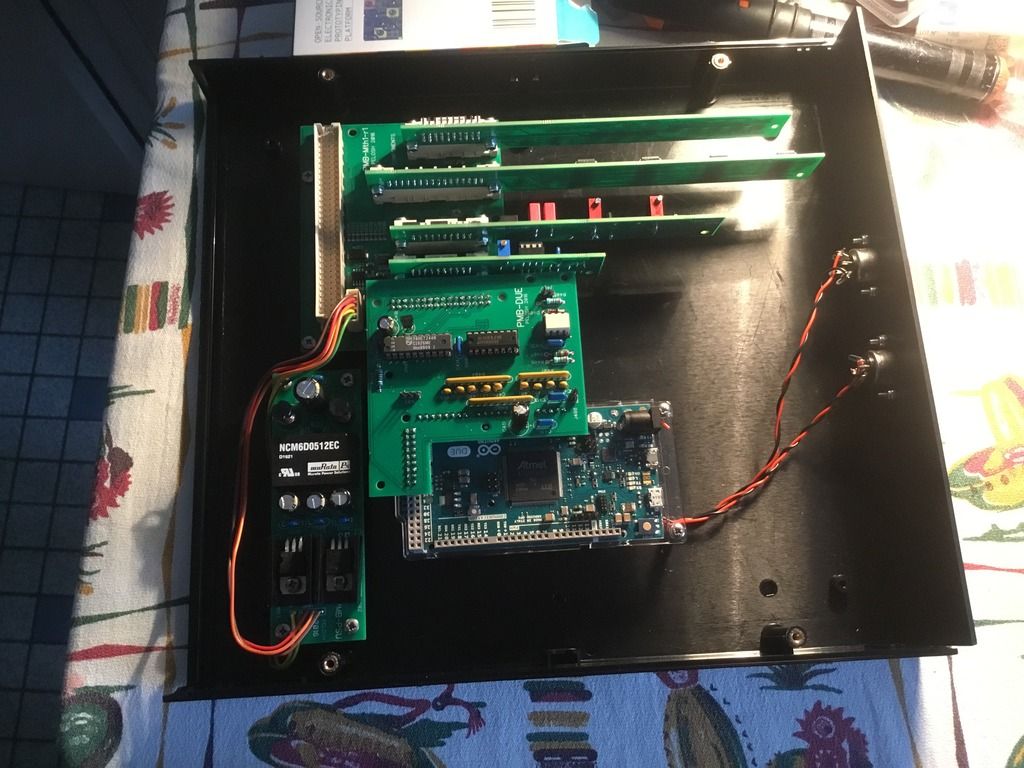

Post by boops » Fri Mar 24, 2017 3:15 am
UPDATE 24/03/2017
The prototype
Working on the code
