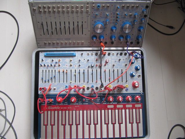

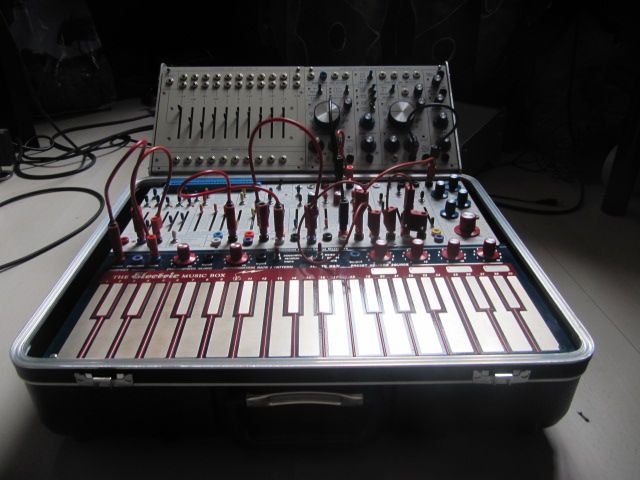

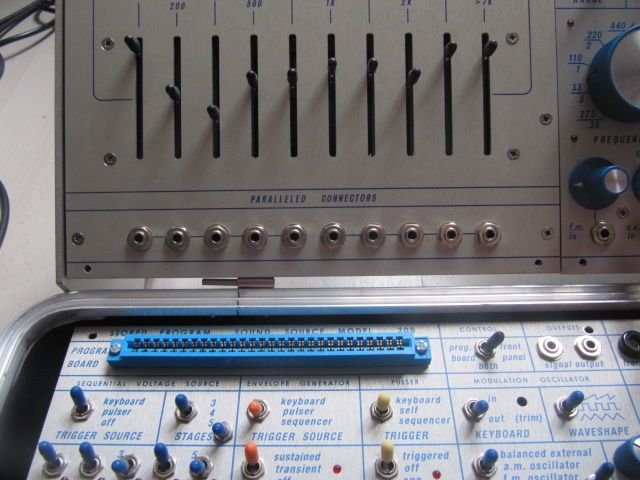

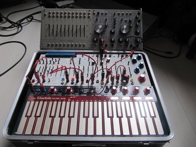

As seen in the video (don't know how to embed it here; please click the link above), the 416 Edge Card with a Program Card inserted, is blocking the left side of the 416 Meta Expander...
A previous version of the 416 Edge Card had a much lower profile, with the Program Card inserted at the front of the Edge Card (which would be incompatible with BEMI's iProgram Card). But it'll still be somewhat in the way.
I'm open to suggestions !
cheers,
_guy

The move the Program Card slot to the 416 idea has circulated my brain for a while, but I abandoned it for several reasons:
  • - It means a complete redesign of *everything* --> another month or more lost.
    - There's not really any space left in the Expander.
    - It's mechanically quite challenging.
    - My IDC cable crimping tool only goes to 50. :-) Such a design would require a 60-pin IDC assembly...
As I said before, the first Edge Card designs were of a much lower profile (Program Card in front), but that only shaves off .75", which is still a bit in the way of the 416 Expander.
I've been using my old 644 Expander hoovering slightly above the Easel on an adjustable laptop stand, which I've found quite satisfactory. Whenever I want to use a Program Card (*), I simply slide the stand a bit backwards to give room for it. Not super-elegant, but it does work.
(*) I seldom use Program Cards within the Easel + Expander environment, because once you start cross-patching, the Program Card loses most of its appeal & functionality. And no, there's not going to be a secondary Expander-Program-Card thing... :-)
I have another idea, but will first test that in my 3D simulator. Hang on...
For now, I'm inclined to just house the Expander in a simple, bog standard 19" boat, and leave its positioning to the user; as some of you suggested. Sliding the boat a bit to the right or backwards works well, I guess, but it's not the most aesthetically-pleasing solution. Though it's not the end of the world either.
I'll be back.
_g

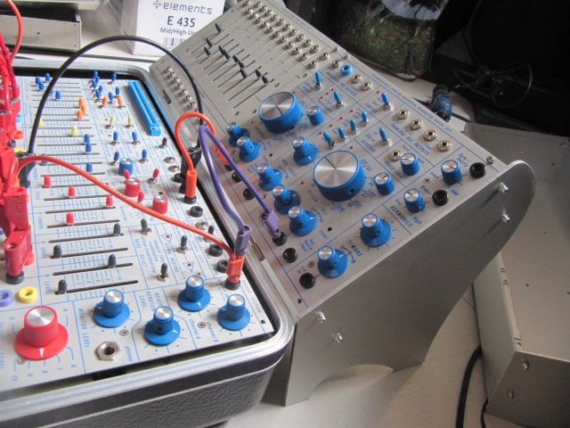

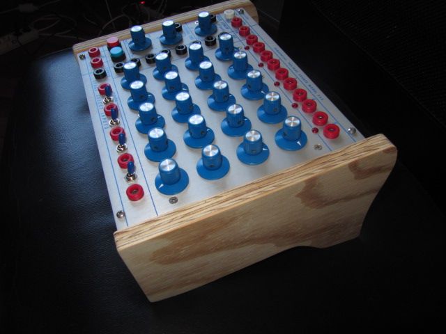

My solutions:
With the almost finished PMB (preset manager Box for 208 rev2 ,i dont know atm If it càn work with the Bemi easel)
It Will use the 56 edge connector too,but as it an external little device No problemo with the access of the expander boat
viewtopic.php?t=140876&highlight=
Imho,the easel,+expander+Preset manager should be a great design tool ,for live and studio sessions.
My solution for the external expander boat (created one year ago)
Here the result with a bemi case
Perhaps ,with a 5U or 6U boat ,the PMB or another 56 edge slot càn be put In the left side of the mega expander?
Wood cheeks possible,too
FS :custom buchla 203 style càbinet ,skiff new design,boat ,hardware for diy cabinet ,easel case ,new 1u to 10u to 56u and more. / New 208 buchla card 12 /
