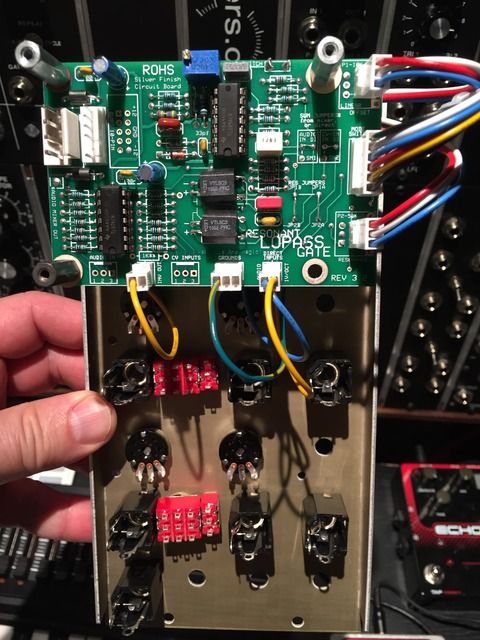

Having started the Triple LPG as a new project I was excited to see this thread in the 5U section. I was a bit disappointed to see that it was basically 3 pages of comments and gripes about the panel. Personally I'm not crazy about the panel either but any DIY project that comes with a panel is a bit of a time-saver. Plus, if you don't like the panel you can buy the PCBs on their own and make your own panel.
Now.... enough about the panel.
Has anyone built one of these? I've got the first PCB built and installed and it works great. One thing I'm not crazy about is the lack of documentation regarding the off-board wiring. I'm still a DIY rookie and only learning to read schematics but I do like some info regarding where all the wires go. Even Ken Stone's modules provide a bit of detail into this. The docs provided by Thomas White (in the ZIP package) are pretty good but this is one thing that's omitted. Fortunately the folks at synthCube have been very helpful in sorting this out and I am making some headway.
One thing I'm a little unclear about is the wiring of the 3 pots on the lower section of the panel. I'm not sure if they are daisy chained to each upper pot or if they come from elsewhere. synthCube is getting back to me on this but while I'm waiting I thought I'd see what anyone who has built the module has done.
I thought about wiring the Inverse Output to each module's upper output jack and the main output to the mixer at the bottom. The boards are very flexible and have many options which are not available through this particular panel design (e.g. Audio and CV Input Mixers). Has anyone done this or something similar?
For this first PCB I've built I'm using two fast vactrols. The module sounds very cool so far but since there are three boards I thought I'd vary the configurations. I was thinking about two slow vactrols on the next board and a fast and a slow on the third board. Any thoughts on this?
Oh I thought I'd mention that using the switches I purchased (Digi-Key EG2426-ND - 3PDT and EG2350-ND SPDT) fit nicely, albeit snugly, soyou can get the orientation correct with the panel's labeling.
Presently I'm waiting for an order of potentiometers I need to finish this (and several other) projects. I also have yet to order the vactrols and I'm curious to hear what others suggest I might use. So far, though, I'm very pleased with this module!
I also have to mention that synthCube has been great at supporting their products. I mean, how can you be unhappy with emails immediately responded to when they're sent before 7:30AM. Thanks guys!

Post by Flareless » Sat Apr 02, 2016 6:26 am
All Done!
This build was pretty easy up to the flying wires where the docs are a bit thin. Once again synthCube came to my rescue with some terrific support. Thanks guys!
In the end I decided to use different Vactrol combinations on each board; Fast / Fast, Fast / Slow and Slow / Slow. The result is that I get some very different sounds from each section of the module. I'll be making a YouTube video shortly illustrating the differences.
I used a passive wiring method to mix the sections of the module out through the bottom. It's a decent solution but if I did it again I might go for the active mixing layout.
I have yet to calibrate each module's single trim pot. I can't find any docs on how these should be set. If anyone has any information on this I'd really appreciate it!

Post by Dragonsf » Thu Apr 27, 2017 10:00 pm
I got 2 modules (ready populated) from synthcube, but they are not working. Problem is: the output is too low. I measured the resistance at the vactrols and the go from 3MB to 1MB (lowest). The measured voltage at the LED inputs are around1.7V. Is the control voltage too low? Ic an hear the effect, but output signal is about 10mV. At the V1, the input is about 5V.
(I tried a different Vactrol from my stock: same behaviour- max 16MB and lowest 2MB resistance). I also tried to feed a LED instead of the Vactrol's LED input: as expected (but not requested) the LED doesn't light up.
I found, when I disconnect 'deep', then the voltage is correct.
