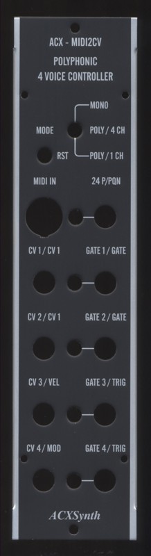

I'm trying to calibrate the MIDI2CV and I can only get about .2 volts total adjustment out of the VOCT pots. Calibrated to 0.0000 CV just fine. I'm only getting a .33 V increase per octave. Any ideas what the prob with the VOCT pots would be?
music noun, often attributive
: personal interpretation of ones auditory experience beyond basic sound recognition
: anything that makes your parents say "turn that shit down"
robotopsy
Posts: 709
Joined: Thu Dec 20, 2012 1:55 am
Post by robotopsy » Sat Sep 14, 2013 11:38 pm
I had the same problem. I managed to run in ableton Live a synth plugin while running the same sequence to an oscillator with the CV2midi and did it by ear. I had a problem with the gate ouputs some modules were always detecting a gate signal even without any midi. I had a 47k resistors to each gate output and it worked correctly.
jmcecil
low order biterness
Posts: 929
Joined: Sat Feb 09, 2013 8:44 pm
Location: Hayden, ID
Post by jmcecil » Sun Sep 15, 2013 8:27 am
robotopsy wrote:I had the same problem. I managed to run in ableton Live a synth plugin while running the same sequence to an oscillator with the CV2midi and did it by ear. I had a problem with the gate ouputs some modules were always detecting a gate signal even without any midi. I had a 47k resistors to each gate output and it worked correctly.
I don't follow. I am at the end of the pot and only get .333 per octave.
