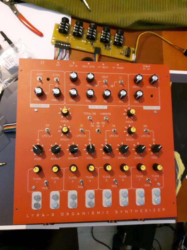

Got my Lyra-8 kit working, yay! I laser-cut an enclosure using 3mm/5mm acrylic and two colour laser etch laminate for the panel. The enclosure feels pretty good but at first all the voices were always on.. couldn't get to the bottom of it without schematic but eventually worked out that the black layer on the acrylic front panel is CONDUCTIVE! wtf? a few nylon washers and end of a a drill bit to make some clearance round the holes and now it works! one of the pitch knobs isn't working but I'll look at that tomorrow - time to play!
The design files are here if anyone interested Github
Image[/img]

That looks really nice, great job! In case anyone else has troubles with a conductive panel, I suggest using a 12”x12” sheet of kapton film. Then you don’t need to worry about the extra spacing caused by washers.

Everything works! No voices triggering all the time. I was worried since I don't have any Kapton film. But I coated the hell out of the underside with a matte coating, and it seems to have done the trick. I also used shrink tubing around each knurled screw. alongside some plastic washers.
Now I gotta figure out a case to go along with the panel. Should have updates this coming week.

Post by Bjarne » Mon Nov 12, 2018 2:22 pm
Branko Nice progress :guinness:
Edit: and I must say I like the orange color
