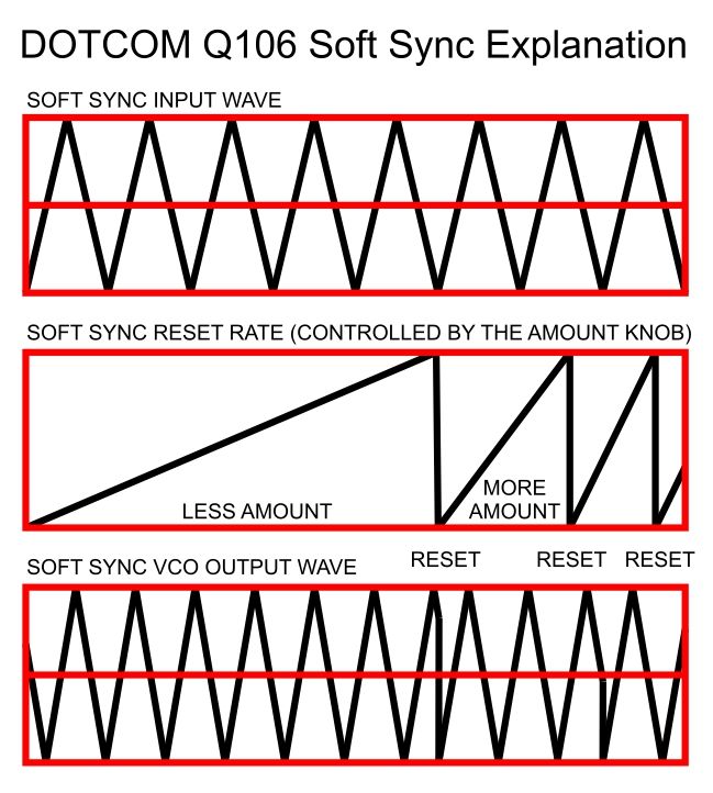

Post by Bryan B » Thu Jan 09, 2014 3:41 pm
I am no expert, but I have used the Soft Sync effect a lot. The first video you posted was mine (crappy I know) and the Triple Soft Sync was a module I did multiple runs of and sold them here on Muff's. That module connects to 3 Dotcom Q106's which saves space (which is the whole point) and as a side bonus, it allows you to use the same input for all 3 (or separate for each if you insert a jack into each input).
I was baffled for a long time as to how it worked and now I am still baffled but understand it a little bit better.
#1 Your input wave is what causes the VCO to reset. I don't know exactly where in the range it decides to reset. The voltage crosses a threshold and then resets the VCO (depending on the amount knob position).
#2 Hard Sync (already on the Dotcom VCO) resets with every waveform, so it forces the Dotcom VCO wave to only take as long as the input. This is done I think by chopping off the waveform and starting it again.
#3 Soft Sync (on the Dotcom VCO) has a range from not resetting (no sync effect) all the way up to hard sync (resetting the VCO with every wave).
#4 The amount control is what gives you control over the soft sync range.
#5 The amount is basically allowing control over how often the VCO wave resets. So no amount gives you no resets (or so slow I can't notice), a little more amount (turning the knob to the right) it begins to reset more often (still not on every wave) like it is waiting and then resetting. Turning the amount knob more resets the wave more often as you turn until it is resetting the wave every time there is a wave on the input.
Below is my first attempt to make a graphic to describe this visually. I am not all that sure how accurate it actually is. This is from memory from a time I was testing the Soft Sync effect and running the waveform outputs into my Oscilloscope module, so it is at least close from memory. :hmm:

Thank you but i still don't understand this. What function's result the soft sync reset rate on your diagramm? Looks like it's the output of an oscillator and the amount controls its frequency.
As far as i know the hardsync uses phase zero for reset, not a threshold.
I'd like to mention that the reversing-VCO thing is also called softsync.
I'll investigate this thing later...
holovicc
Posts: 148
Joined: Fri Nov 23, 2012 11:15 am
Location: budapest, Hungary
Post by holovicc » Sun Jan 12, 2014 8:56 pm
Oh yeah, it definietly will not be right about my statement about the phase. Emailing to Roger right now.
