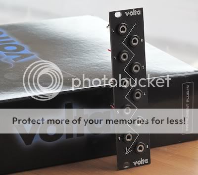

Ill see if i cant find a photo of it later, but somone asked me to cut a 4hp euro panel for his setup some time back. I think they were just planning on using the standard cliff jacks, to match their other euro modules.
Hmm... i cant find a photo of the finished item, and it looks like it wasnt 4hp either, but here is their design -
Im sure i did see a photo on this forum of the item in use, but, where - who knows!

via this thread:

Junk Rhythm wrote:via this thread:
Yep, that was the one - thank you.
I seem to remember that i cut two at the time, so there must be another user out there with the same panel also, but i cant be sure of that at the moment.

Post by julian » Sat Mar 05, 2011 11:33 am
I think Steve/Monobass (the owner of the one in the photo) sold his whole volta system -
Do you find the panel usefull in your setup?
I made a couple for my own euro system years ago, one from my kenton pro2000 (which i found very usefull) and some bus ones to the mixer, but i moved before i really started using them (and had to downsize the huge 8-bus mixer to somthing more sensibly sized!)

julian wrote:I think Steve/Monobass (the owner of the one in the photo) sold his whole volta system -
yeah it was a great panel but I'm moving to a new case where everything goes in the front, won't be able to have any bus lines coming out of the back of the case... which is a shame in some ways cos I prefer to keep things tidy.
