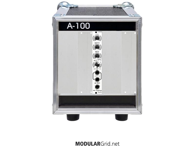

Hi. I dream of building a modular system.
I've got the polysynths and pads i need, so my thought was to build a system capable of some gritty bass, and at the same time have some modulation capabilites for outboard gear.
My idea looks like this so far.
https://www.modulargrid.net/e/racks/view/256916
I've put them in the order i'm planning on buying them (from top left to right, and then second row). I've also tried to get some multi-purpose modules to get me started. For example the TipTop VCF, that would also work as a VCA.
What i'm definitely lacking is an envelope generator. Although i know maths can do it, i would like some inputs on which other opportunities you guys like, and if there are some essential things i am missing.
I'm in love with the polivoks, that's why i chose the vco and filter.
vytis
How are you going to be sequencing? You could kind of do it by feeding EON > Disting in quantizer mode, but I think you badly need a Sample & Hold. Get a dedicated dual S&H such as A-148 or a second Disting. A quad LFO such as A-143-3 or at least Pittsburgh LFO2 would open up the system and free up Maths to do other things.
wminor
Between Maths and Peaks, that's a decent amount of envelope generation for a small system like that. If you wanted more, you could always add a Function, or another Peaks (remember it has a few modes so is super versatile). EDIT: Just noticed the EON as well. I think you're alright for EGs to start with imho.
The Zularic Repetitor seems like an unusual choice with the rest of that. I have one, and I like it, but all it does it generate triggers. You don't seem to have a lot that triggers would do much for... what are you planning to use it for?
OskarHD
Hi. I forgot. I have both an SQ-1 and a Tanzbär which has 2 cv-outs. I planned to used them for triggering.
The zularic repetitor and the clock divider, where meant for some coming percussion modules and outboard stuff, as i like playing with complex rhythms, and simple bass, as opposed to the other way around.
I'm checking out the LFO's
Thx a lot

Richie Hawtin's minimal techno rack:

Orwell
Ha, smart one! Gave me the giggles

hinterlands303
You forgot the reverb module with the knob broken off at 100% wet.
