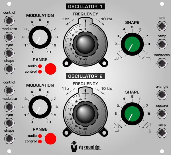

Yes, the other one was a dual oscillator with vc waveshape. Fun layout with its obvious vintage appeal and vernier dials, but I'm kind of glad to see a move away from such things. The dual panel seemed a bit of a funny design, with no obvious interaction between the two oscillators in the mock-up (not even sync switch). More a design dictated by nostalgia. The new one looks nice and compact, probably a better panel size/density for Euro, and the modulation drift seems like an interesting touch. And the $200 intro price looks nice, too. It will be fun to hear what it sounds like.
STG does share a lot of never-to-be-released design concepts, but everything that makes it to the finish line that I have used has been top-notch.
The old vco design:

I believe it is a logical progression of the same core design but I too am a little ignorant of the exact similarities.
As is the case with most of STG Soundlabs modules there is a foundation on some vintage design with the added imagination of Suit & Tie Guy to enhance beyond the simple clone. This is no exception and offers some very musical features like the potentiometer step weighting of the SEMItone control and Range knob as well as the inventive drift parameter.
The vco offers LFO, octave switching, sub oscillator and free 5 octave sweeping all in the compact three knob design. This amount of tuning control is usually a tradeoff in most vco's. Not here. You get it all. Dynamite comes in small packages.
I have two of these on pre-order. The sync function is another unique variation. The sub oscillator (square wave) is generated off the core reset so it is a bit different than some. I can see these paired well for a very unique sound. I'm anticipating a lot of dynamic harmonic performance with the drift and sub oscillator sync in play.
All-in-all I am more interested in the whole feature set of this VCO than I am of a clone of the British vintage oscillator but that is just my perspective.
