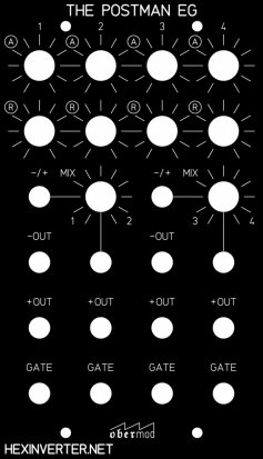

Quad / Postman EG from Hexinverter work fine. Designed Frac panels for 'em. Came out great!

dJ dAb wrote:Quad / Postman EG from Hexinverter work fine. Designed Frac panels for 'em. Came out great!
Panels look good! How did you make them?
