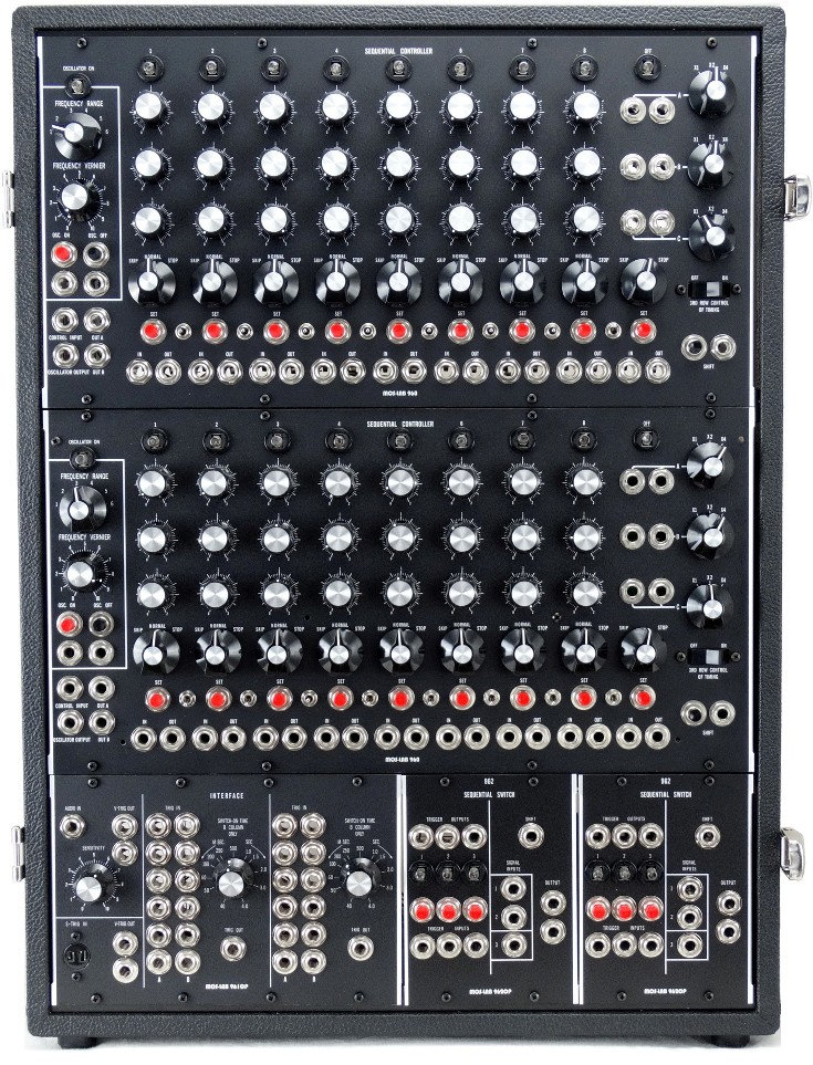

I'm curious to know what your thoughts are on two (2) Moog 960s (pic below) with their utility modules compared to the rest of 5U sequencers ?
How much does having the IO on every step matter compared to other sequencers that have more features but not the IO on every step ?
Are there any advantages of having this sequencer set-up in one portable case
or is this a disadvantage some how ?
I was interested in this set up because I believe Tangerine Dream used something similar in their early classic period and also by Morbius pattern bussing technique video below .
This is primarily for melody and historical educational purposes .
The Moog sequencer cabinet is definitely gorgeous and lust worthy but you could get almost the exact same look and functionality with Synthesizer.com products for less then 1/3 the cost of the Moog?
Also the same thing with Mos-Lab and COTK products for a little more than the DotCom offerings. And while I know that limitations are golden for inspiring creativity, there are more advanced sequential switches and gate handlers from COTK and Moon.
And if you want to get further away from the traditional look and design but still have 98% of the Moog functionality plus TONS more ability, you could go with an all Moon setup for only half the price of the Moog? hihi
Dave Peck
Plus, if you go the Dotcom route, you have room for adding a quantizer or two in the same cabinet.
And if you get the Moon version, the quantizing is built into the sequencers.
ranix
those two open spaces are looking pretty juicy for a dotcom quantizer and a quantizer aid, the latter of which even produces midi output

I have the double 960 dot com, plus a quantizer and slew on the bottom. I use the slew a lot when it's creating envelopes.

you really will need quantizers for the moog 960, and moog doesn't make any. we're going to eventually get some .com quantizers and a few other modules for the vintage moog system 55 we refurbished for our studio as these extra modules will definitely make the sequencer way more useful.
mini
mutierend
I love aesthetic of the 960 (I have the dotcom version) and, while it costs as much as a way more capable MIDI sequencer, I like the challenge of getting what I want out of it. For example, ratcheting with a Cirklon, Pyramid, or Koma Komplex is super easy. Ableton's beat repeat does it too. But with the 960, depending on how you want to do ratcheting, you need another oscillator and a switch.
And I like that. A lot.

I can highly recommend this setup... I just purchased the Walnut Cabinet version a few weeks ago... it's awesome... thumbs up

Well . . . . now I'd say you should consider the GRP R24! For under $2000 it comes in its own portable desktop case with power supply, has built in slew, ratcheting, clock dividers, quantizer, pattern generators, trigger/gate buss, MIDI I/O, and MEMORY so you can recall complete sequences, etc etc

I disagree, I think the 960 is one of the most powerful sequencers especially if you have two. The "or" module (Q960 or the INTERFACE modules in the photos above) let you do crazy things like mix two 960s running at different rates or with different gate lengths and patch individual stages to create multiple patterns from the same sequence. It fits the way my brain works for like the "top" level of sequencing and clock dividing, if you know what I mean?
