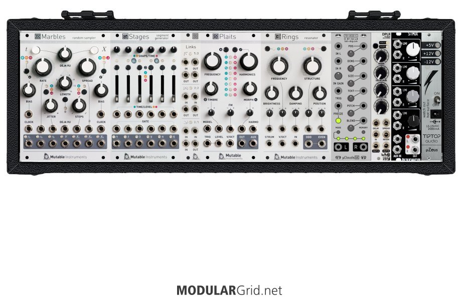

Here’s something that fits in a HEK:
The Mutable sequencing and CV mangling section will give you any of several flavors of sequencing, a SoU, and probably more modulation sources than you need, there’s your Cs-L and an LPG next to it, nice mixer for gain staging voices, and a Disting to be whatever you find to be missing in a patch (alternately, replace LxD and Disting with an Optomix, I guess).
