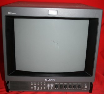

wcfields wrote:Ideally you'd want to get a Sony Trinitron CRT... The "HR" models (High resolution) can do 600 lines.
Actually 800 lines is the spec on the later ones. I've got a PVM14-M4u. They have so many different inputs! accepts NTSC, NTSC (4.43), PAL, SECAM in Composite, Y/C and RGB, and Y/R-Y/B-Y formats. Many years of incremental improvements in that line of gear.
