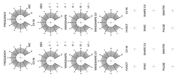

The latest design:
ali_g12
Posts: 143
Joined: Sat Oct 12, 2013 3:00 pm
Post by ali_g12 » Fri Dec 06, 2013 2:42 pm
I'll probably get these done a couple of times on the dibond stuff - once as a photo print on aluminium dibond and another set with inverted colour scheme on brushed aluminium (black letters on alu dibond). I'll let you know how I get on!

Here you are folks - front panels on dibond!
